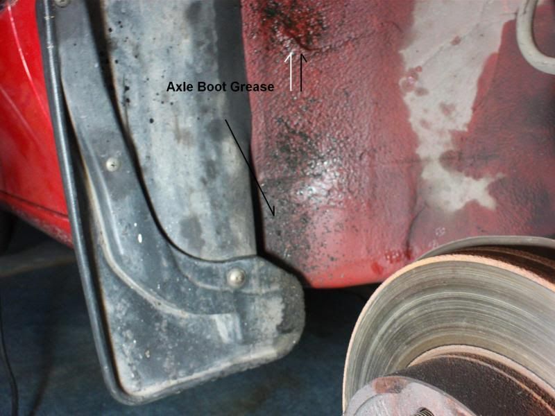

The first tip I have regards observation.
Take a look at the 'wheel well' area where the front tire spins.
If it looks like this:
You'd better take a closer look.
In the situation above, the CV (constant velocity) joint boot has ripped and it is spreading grease as the tire spins.

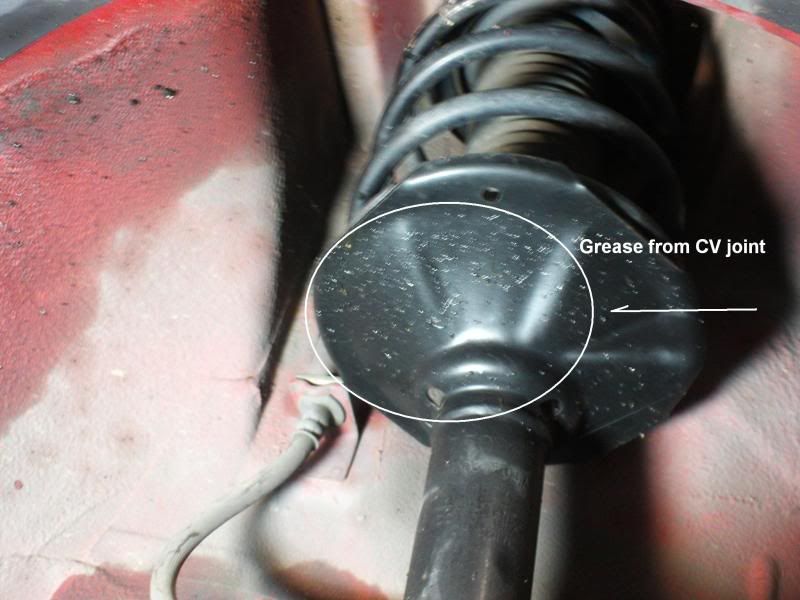

Next tip I have is another area which you can observe for the same reason.
It is the base of the front shock absorber.
If you see this
consider the axle boot again.

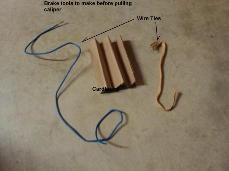

Third thing I can point out is tool assembly.
Try and prepare a few odds and ends to help with the brake job prior to doing it.
For example, you'll need some kind of wire to hook your caliper to the front spring and
a small piece of cardboard (possibly).

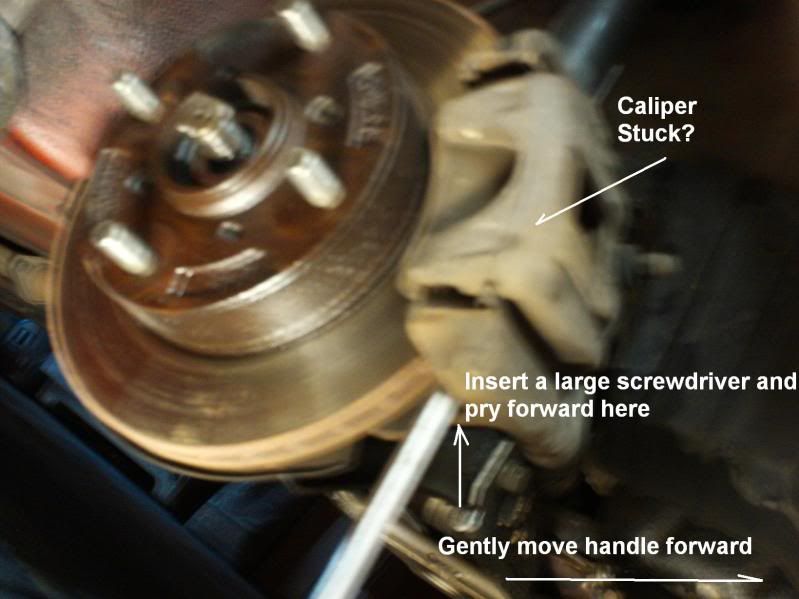

Suppose the caliper is stuck on the rotor (it happens).
Just put a large screwdriver on the edge (not face) of the rotor and pry toward the front of the car
(here, passenger side shown) and it should lift off easily.

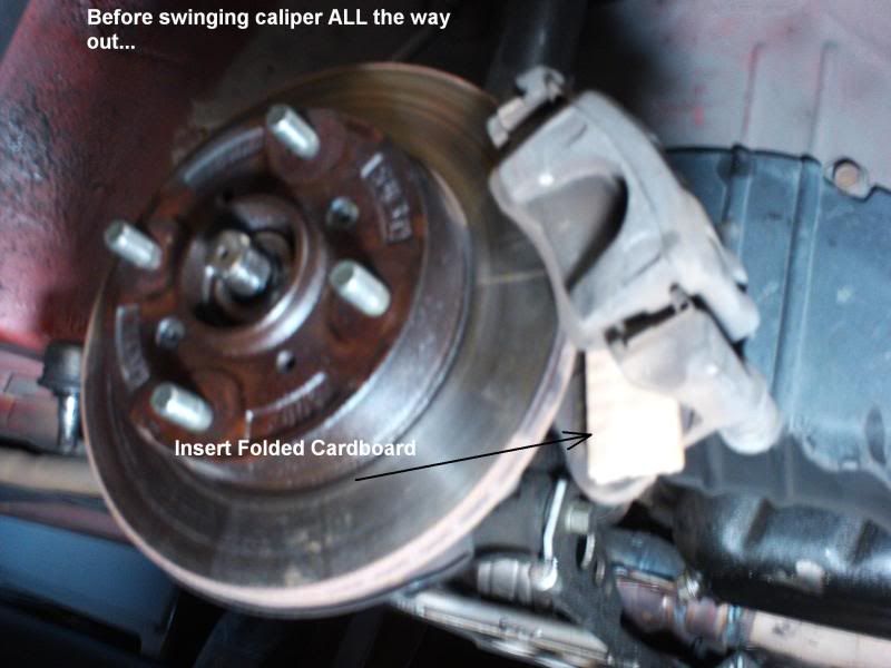

Here's a tip on calipers.
If you are not going to remove the brake pads, then use that piece of cardboard and slip it into the space vacated by the rotor as you lift the caliper off.
Here's a picture
showing the cardboard going in.

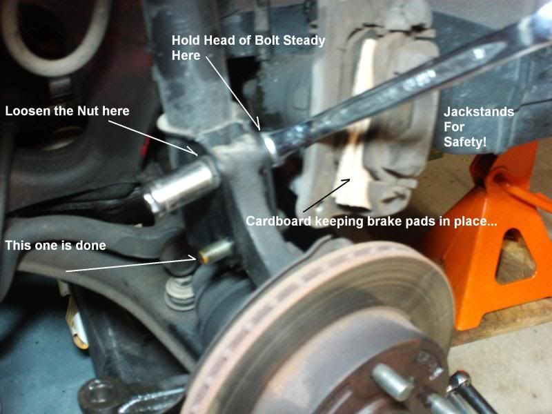

Here's a tip on removing the knuckle.
When you remove the two large diameter bolts
Hold the head of the bolt and turn the nut to remove it.
Don't hold the nut and loosen the head of the bolt.
You will encounter less resistance/friction and it will be easier.
Start with a 'breaker bar' and then, once you have loosened it a quarter or half turn, you can move to your ratchet.
