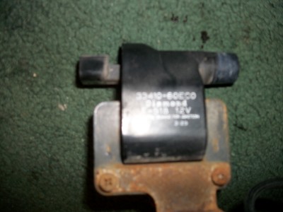

Thank you, I have the ignitor from the turbo car, from what I can tell in the wiring diagrams I basically just tie it into the coil wires and into the engine harness. I also did pull the charcoal canister, but didnt know it was different, so that helps. I found a tach cluster on a mk4 I parted a while ago, so I have that in my car now, I will look into the turbo light, that i didn't even think to look at!. oh y and I did grab the fuel pump too. Debating to relocate my filter or change the current one while the tank is down. I was unaware the mk5 and gt pumps were the same, will come in handy if this one packs it in.
I have read I need to use the coil from a trubo car, when I went to take the nut of the stud it just broke because it was too corroded, will my mk3 coil work or do I need to buy an aftermarket one now? worst I can see is not enough spark at higher rpm's, if I can I will leave it for now and wait till I come across a deal on one.

maybe I will solder on a spade connecter terminal to the broken stud and use the turbo coil to be safe. I have the newer different looking coil. this is the coil I have...
The noise suppressor in the original harness should be sufficient, shouldn't it? or should I be swapping that as well?

I have both currently, don't worry about a part number. the blue cap one is from a turbo3, and that is what the turbo car had, the pic above is the style coil I have.

I will update some pics when I get home. But its running good :) I kept the OEM coil that was in my car for now

correct that the blue top coil is the one for the stock turbo3. the air core coil that you have in there now will probably work fine. suzuki used that same coil in the gt and it had a pretty hot ignition system.

from the pic above that shows the coil, the component with the finned heatsink, white wires, and yellow cylindrical connector is a vestigial part of the normally aspirated g10. it's function is that of a big resistor used for impedance matching the throttle body mounted injector for the normally aspirated engine. you can remove that from the firewall, unplug it from the yellow connector, and toss it in the box with the other junk from the swap. :lol:
Perfect :D I like less junk under my hood.

I would recomment using the coil off the g10t as it delivers a stronger spark, but the one from my donar car was no good so I am using the oem one for the time being, but to Install the ignitor you connect two wires in with the coil wires and the yellow and orang wire run to the engine harness(I didn't solder them because I will be pulling a plug in line, and yes I forgot to shrink the heat shrink butt connectors)
