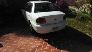

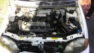

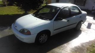

So this is my Chevy Metro LSi. It's a 4 door sedan with one of the worst transmissions I've heard of. A 3-speed automatic in a 2000? Thought we were past that, guess not. Anyways, here are some day 0 pictures. This was me checking the car out.
He was asking $1,800 on craigslist. It has been up for 3 weeks and he was ready for it to sell. I ended up taking it off his hands for $1,400. I thought it was a good deal. It was a one car owner, still has the original warrenty stickers and stuff on it. 120,000 miles but the motor runs well.

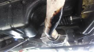

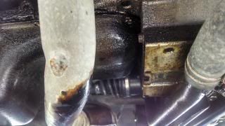

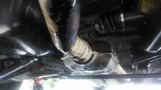

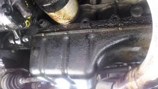

Anyways, here are some photos of it back home. It made the hour drive quite fine. A few things I need to address. The oil pan issue and it seems to be missing a lug stud. Which is strange. I'll have to pull the wheel off. If it is missing I will get a new one and hammer it in. I also need to look into changing the ATF. I will look around the trans a bit.

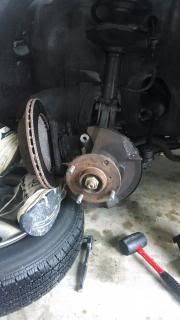

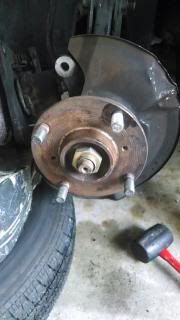

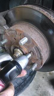

There is a chance you will have to replace a wheel stud like I did. It isn't a hard process, just requires a little guiding if you haven't done it before. Here is a quick step by step guide with photos.
You will have to jack up a car for this. There is a central jack point on both ends of the car. For the front this is the front crossmember. In the rear there should be something very similar. The 'jack points' on the side are actually for jack stands. Never trust your life to a jack, use jackstands.
Tools Needed:
-Jack and jack stands
-19mm Socket or prefered way of removing lug nuts
-screw driver
-14mm socket/wrench
-hammer
-punch

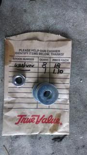

-stud seating kit
"Stud Seating Kit"
Basically just a stainless steel nut to use instead of the lug nut and some washers. I picked up 8 at this thickness. Should be able to buy this whole thing for under $3.00 at your local hardware store.

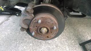

1. Locate the broken or missing wheel stud.
2. Remove the wheel by loosening the remaining lug nuts. They are 19mm.
3. Check out the damage. In my case the whole stud was missing, not broken off. If broken off: After removing the caliper and rotor, use a punch and a hammer to remove the broken stud.
4. Unscrew the rotor from the rest of the hub. Use a thicker phillips head if possible, you don't want to strip this screw.
5. Remove the 2 14mm bolts that hold the brake caliper to the main hub. You should be able to remove the rotor and brake caliper easily after this. Set it aside, but supported.
6. You may have to shift the car into nuetral and rotate the hub until you can slide the stud in from behind. Caution: If you are putting the car in nuetral, (automatic or manual) pull the emergency brake and put stops behind the wheels. After you slide the stud through, use your washer and bolt to pull the stud through. You should apply new motor oil to the threads prior to tightening.
7. The stud should be fully seated. You may only need a couple washers at first, but more after it is partially seated. Remember to try and use all the threads on the bolt when pulling the stud through. It will help from ruining threads.
8. Reattach the rotor and brake caliper, put the wheel back on, and now you are done.
Congrats! You've successfully replaced a wheel stud on your car.

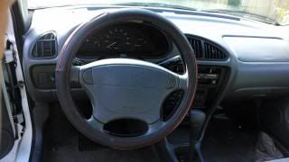

Steering wheel wrap: $6

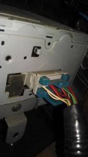

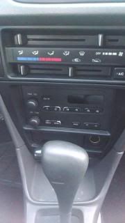

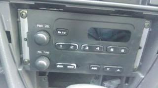

Still not half bad. I took the radio out to measure the opening, current radio dimensions, and look at the antenna before I purchased a new unit.
Stock Radio
Pull out the ash tray to remove 2 screws
Then remove 2 screws on top
Pull the bezel out and pop off the cigarette lighter
Remove the 4 screws that hold in the radio
Remove the hidden screw underneath the radio, behind the ash tray.
Reach behind the radio and pull out the clip and the antenna
Now you are ready to measure and order a new radio!

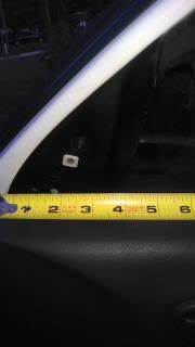

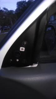

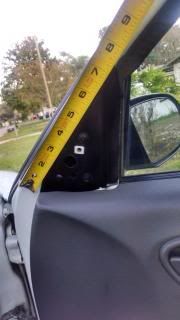

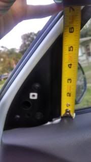

Our car is missing the panels for the mirrors
So I measured them...
I think I will fiberglass a piece to go there, paint it black, and sink the tweeters into it. Then run the wires through the stock grommets.

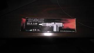

I have a keyless entry system, I could only find one door actuator. I know where the other one is, but I forgot where the box with the actual unit is at. None the less, I plan on installing this on the front doors for now. Rears in the future.

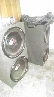

And here are some of my subwoofers I removed from my other car. I'm putting the smaller set in the Metro, selling the other, keeping the 2800w amp on the side, and throwing the 500 microfared capacitor in the trash. I have no use for it whatsoever.

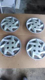

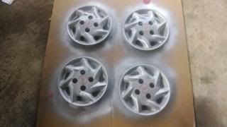

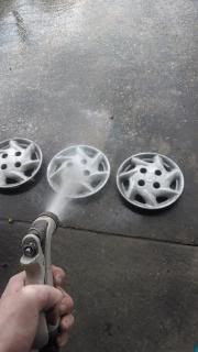

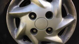

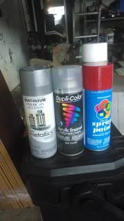

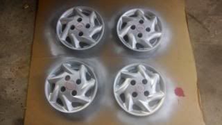

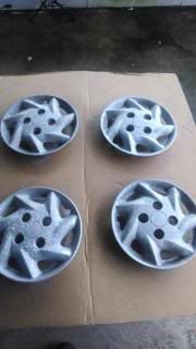

Cleaning them up
First coat of silver/gray
Painted the circle and Chevy symbol red
Can't tell, but this is clear coat

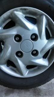

Overall, they turned out alright. The hub caps were pretty beat up. I'm just glad they are all the same color.
On the car

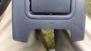

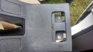

Next project, a center console.

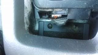

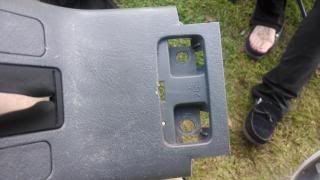

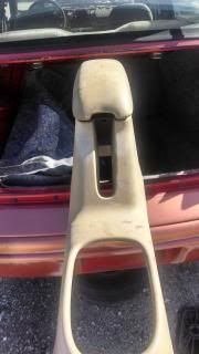

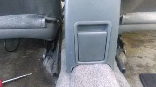

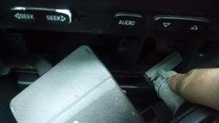

I found a 2000 or so Dodge Neon center console. It doesn't match my interior, so I went with something else!
Remove the rear screws
Remove the screws on the front portion also
This is so you can reach the lower screws
Then you can just tilt the console up and remove it

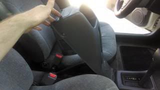

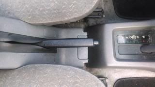

Peak at my new arm rest... Have to trim it
Test fitting it
The screws line up now
I trimmed the front too much, but it's not the worst I've ever seen.
Shot of how it looks in it's final position
Looks stock to me personally. And it's pretty perfect for the car overall. It's not the largest arm rest, but it gets the job done. It is out of an EG 4-door Civic (92~95 I think). It's almost an exact fit. It's pretty amazing.

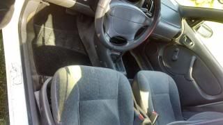

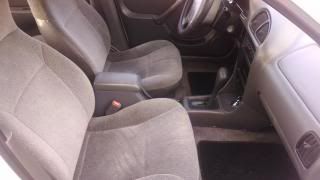

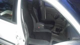

And I put some seat covers on.
I have to put the back seat cover on still. That and clean the head lights with head light restore.
