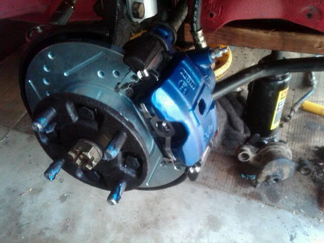

This car was hammered. It had been really abused and neglected by the previous owner who did a lot of off-
roading. Everything I touched was connected to another worn part. A simple strut replacement turned into
inner tie rods, outer tie rods, lower control arms, new springs, new struts, new strut mounts, sway bar/control
arm bushings, bearings, brakes, brake hoses, axles. The biggest problem was the left side. The axle would not come
out of the hub after several blows with a sledge, so I removed the whole assembly and tried to press it out with
a 20 ton press but ended up bending the steering knuckle. 2 Used steering knuckles later, new bearings, sourcing
all the seals after getting the wrong ones (idiots), cleaning up the knuckles (they were in baaad shape), new rotors,
calipers, upgrading to 12mm wheel studs..blah..bla..
All new poly bushing upgrade from Whiteline

Kinda slow at work today, so I got a chance to upgrade the rear studs
to match the fronts I did a short while back.
Unfortunately, the brakes are toast (explains little or no pedal),
but I knew that 'cause the parking brake barely works.
So only had time to do the studs.
Ended up being the quickest stud swapout ever in about 25 mins.
The old ones came out real easy, tap tap, not like the fronts on the rusted
junkard hubs I rebuilt.
