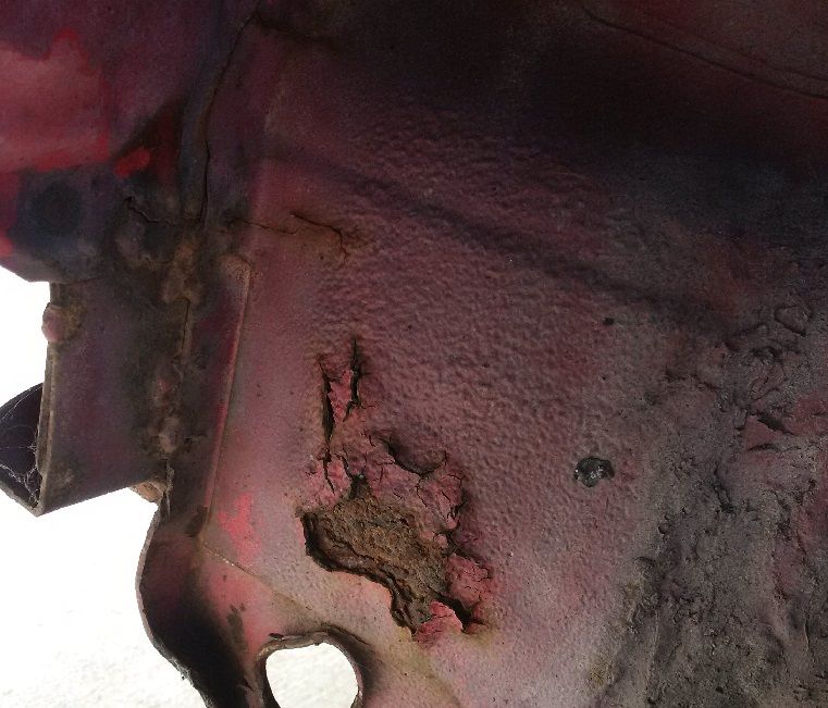

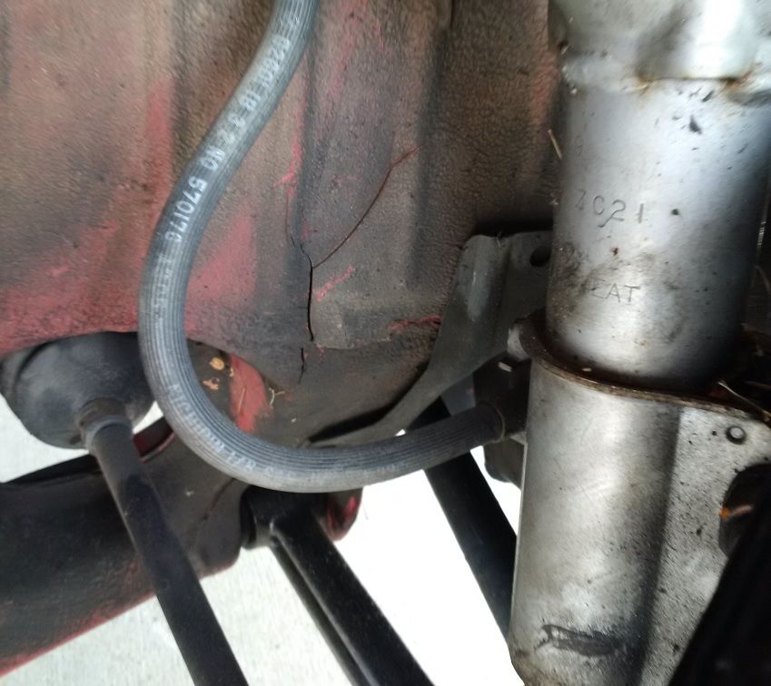

However, when I got a good look at it the next day I discovered some nasty
damage, causing a lengthy delay in the front end overhaul.
Now this is pretty typical, and most of my sprints have some smaller cracks
of some sort or another in this area, but didn't consider it a problem till I discovered
the other side.
Now I consider this severe, and the after installing some new parts on the front end,
it was pretty obvious this is about to give way, the way this thing was handling after
tightening up the front end. And now looking back, it's very apparent what was causing
the low speed noise, clicking and groaning, which is similar to loose hubcap noise and
which was what I thought was a bad CV or bearing, but was actually a load bearing area
slowly giving way.
Well it took a while, but I was able to line up a skilled fabricator who was willing to do a repair,
as most other body/collision shops shuffled me out the door not being interested at all.
So I got it dropped off today and hope to have it back next week. We will see what happens.
Also asked them to clean up this typical rust area.
The guys pretty diverse, and does quality work, so I'm keeping my fingers crossed on this one.
Will update when the repair is done.

Eek! dont forget to check under the carpet for cracking around the gearbox crossmember.

I have - on the one I saw, the front radiator support was also rusted inside. Some bright spark had welded up the cracks without fixing anything causing the cracks. So ..... it cracked again beside the weld.

Finally got the bad spots patched up.
Time to finish up the front end and get it aligned.
