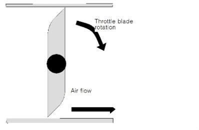

I did this to my Saturn SL1 while I had the TB out for cleaning. All I did was to carefully grind the trailing edge of each side of the throttle blade, then to radius it with the wire wheel. I only did it to 2/3 of each edge, so that the sealing portion of the blade was not affected. Do not take the sealing edge away, or you will have muchos idle RPM. It makes a huge difference on throttle input when cruising, not to mention making the engine quieter. I take it 35 mpg average out of this engine with an automatic is good.... Try it for yourself.
My theory was that at light throttle, the air glides over the blade vs. stumbling over it.

Good idea. I did this on a modified throttle body I have.
