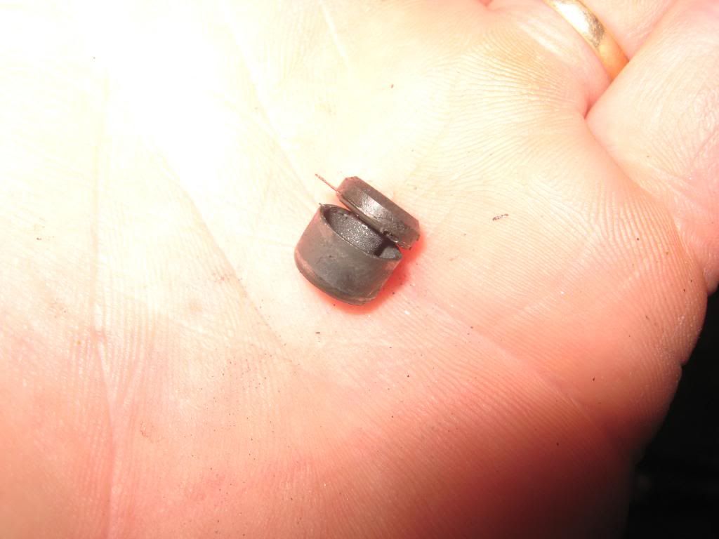

I took a stab at doing this mod http://geometroforum.com/topic/4804867/1/ ( I know I know, but I wasn't able to find any references to this mod on this beloved forum)
I was worried about spring pressure so I cut my spring so its resting height would be just tall enough to seat the plunger. After 3 weeks of flawless function I'm starting to have erratic idle issues... mainly with the "rolling idle up" function. while decelerating, the idle will surge to just over 2k rpm then drop to 1k until the vehicle comes to a stop. Then it idles down like normal. Being that nothing has changed on the car/engine except for an oil change and trans fluid change I'm thinking my spring has fatigued a bit and is not providing enough resistance.
Anyone else have any thoughts or experience with this mod?
thanks!

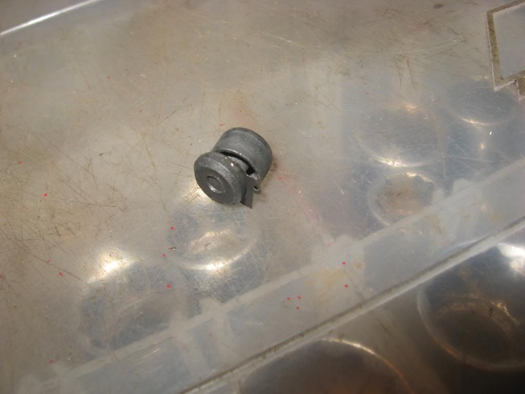

This may have happened to the plunger.
Your symptoms sound exactly, like what happened to me, when the plunger base let loose.
To fix the plunger, I cleaned really good with brake cleaner, dried with compressed air, and filled the void with Permatex RTV Red High Temp. Press the two pieces together, tape to hold, and let sit over night to dry. Sorry, I neglected to take a picture of the finished product.
I have over 12,000 miles on this IAC mod/repair now. Still operating as it should.
If the plunger is still OK, then you may want to stiffen the pen spring a little. Hope this helps.
