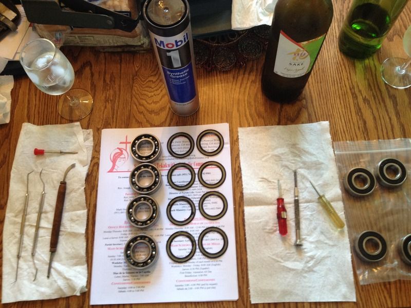

Here are 8 bearings with the dust covers removed CAREFULLY using a pair of dental picks on the 4 left ones.
The 4 on the right are probably done or about to get some minor surgery. 8)
Actually, if you STUDY the picture you'll see the tools I'm about to use:
-small screwdrivers
-dental picks
-leather working tools
-COLD Saki (optional)
This is what I call 'benchwork'. You buy new bearings. Take them apart and grease them. Then they are ready when you need or want them.

Back to the wheel bearings:
In our climate, you want to have them lubed, but too much grease (outside the bearing) can actually migrate onto the drum in our hot weather.
I put them on a Church Bulletin
so that they get a little good luck
and grease them with a small spatula.
Other people have fancy grease packers but you can get by without one, cheap as they are.
Grease has a tendency to last a long, long time when I do it this way.
But before I put the covers on, here's what I've got:
And remember a while back I said I upped my game?
It's that red stuff.
They call it Mobil 1 wheel bearing grease.
I might not be using it in the right place, but there you have it.
After greasing them all, I slap on the covers again and put them in as dry as a bone (on the outside).
